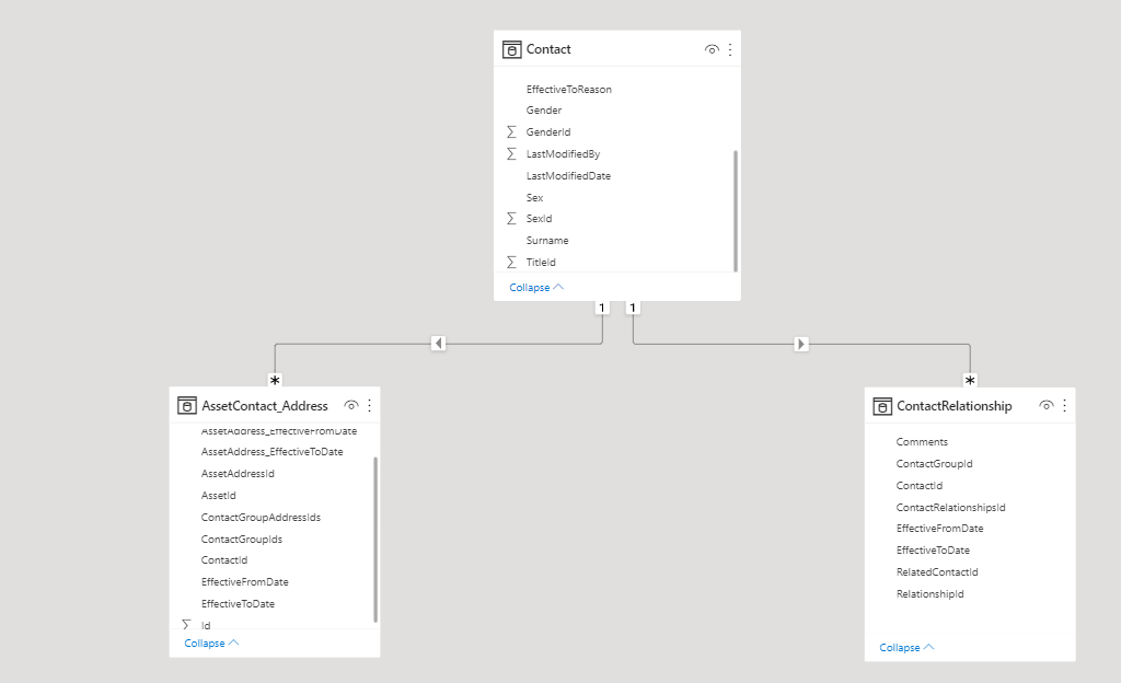

      I got a data model which looks as follows:
      I am trying to show columns from different tables in a table visual. Table visual works fine when I use columns from contact and AssetContact_Address tables. However, it throw an error ‘cant determine the relationship between two or more fields’ when I tried to put a column (any column) from the ContactRelationship table. I checked and there is no missing value in any table. I also changed the cross filter option from Single to both but did not work. Any help would be really appreciated.

      I think the problem is Power BI cannot determined or establish connection between the other 2 tables although both are connected to table “Contract”. Try to create an aggregate formula in any of the other 2 tables e.g. count (contractRelationship[ContactId]), then include it to your table.

      RD is correct. The relationships are both one to many. The table visual can’t deal with that. Change it to a matrix and it will stop throwing errors. Any displayed data will need to use either an aggregate or measure that that returns a single value.

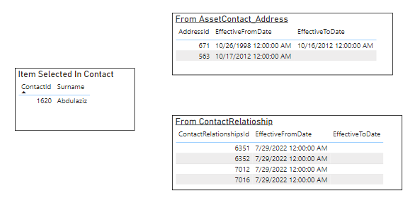

      I think it would be easier to understand the issue if you take a look at a smaller portion of the data.Ā  For example, let’s take a look at ContactId = 1620 from the Contact table.Ā  That item has 2 rows associated with it in the AssetContact_Address table, and it has 4 rows? associated with it in the ContactRelationship table (see image below).
      If I ask Power BI, what information is in the AssetContact_Address table for my contact, then Power BI can answer that question with this sort of table, where it shows me the two rows from AssetContact_Address table and just duplicates the information from the Contact table for each of those rows.Ā  That’s logical, and easy to understand:

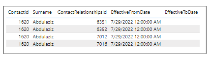

      And the same would be true if I ask Power BI, what information is in the ContactRelationship table for my contact, I would get this, which is also logical:

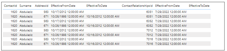

      Now, if I ask Power BI, what information is in both the AssetContact_Address table and the ContactRelationship table, for my contact, and show it to me in just one table, then it’s pretty confusing.Ā  Power BI is wondering how can I show the information from both of those tables on the same rows?Ā  Is the user looking for something like this:

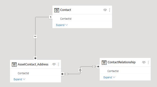

      That would give you all of the data you want, but it’s pretty confusing.Ā  Instead of the two rows from AssetContact_Address or the four rows from ContactRelationship, now you have 8 rows – basically it multiplied the rows together.Ā  For this small example, that’s not a big deal, but you can see that for the larger data, that would get to be a lot of unnecessary duplication, and produce a table that’s very hard to figure out.Ā  By the way, if you are wondering what I did to create that table, I changed the relationships in the data model, so that it looks like this instead:
      Let me be clear, I only did that for the exercise.Ā  This type of model is a really bad idea, and will be hard to manage going forward.
