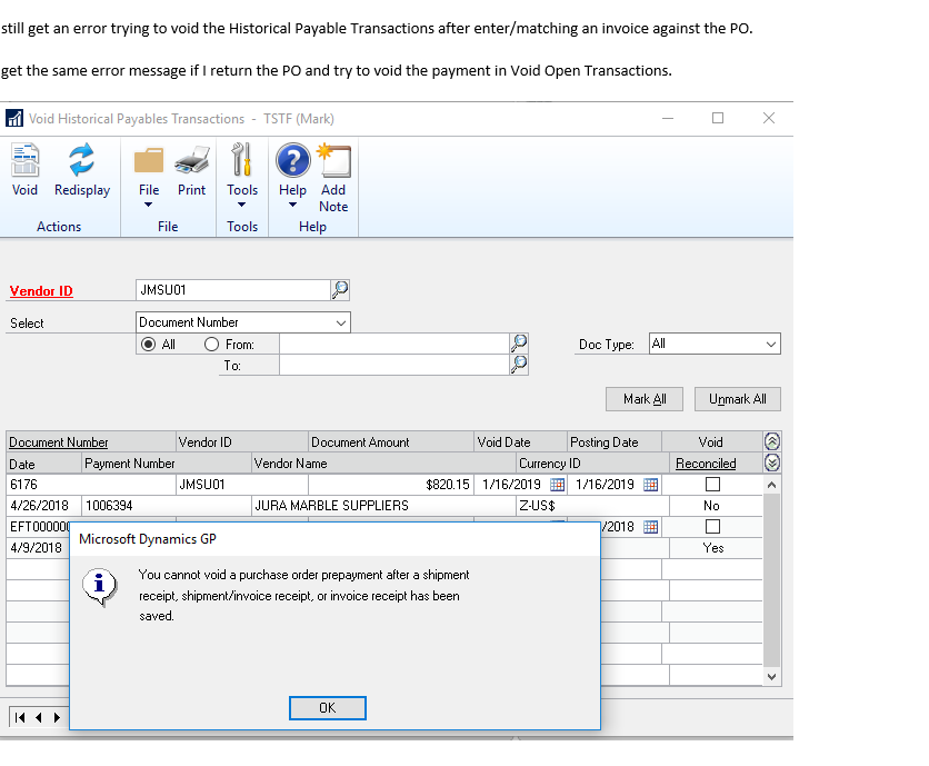

      We receive the below error when trying to void the check

    • Shari Bruno
      January 16, 2019 at 5:24 PM
      When you did the Returns Transaction did you check the box to “Replace Returned Goods”? If so, have you tried removing the PO invoice and receipt? I’m thinking that may not work because you can’t void the check, but it may be worth a try.
      The transactions and check can be removed through SQL, though I’m not a fan of that, especially with a reconciled check attached to it.?
      You mention that the materials were never received, has the vendor issued you a credit?
