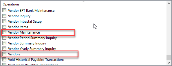

      July 31, 2019 at 3:41 PM
      I, honestly, do not think so, but you can test out the two operations below by creating a new security task and assigning one of them to it
