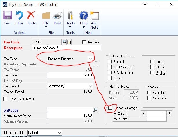

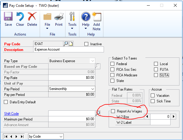

      Unmark the “Report as Wages” check box on the Pay Code setup and roll it down or unmark individually on the Employee Pay Code Card.
      You can also mark that box and then route these reimbursements to a separate line/box on the W-2 while keeping them tax exempt based on the Subject To Taxes check boxes.

    • Thaddeus Suter
      January 17, 2019 at 5:26 PM
      The Pay Code must be Type = Business Expense for the ReportĀ  As Wages option.
      If so, then the Report As Wages will Not be grayed out.
      If the Pay Code is any other Type then the box will be grayed out and the pay is wages – w no option to exclude/include.
      So take a look at your Pay Code and make sure the Type is Business Expense
