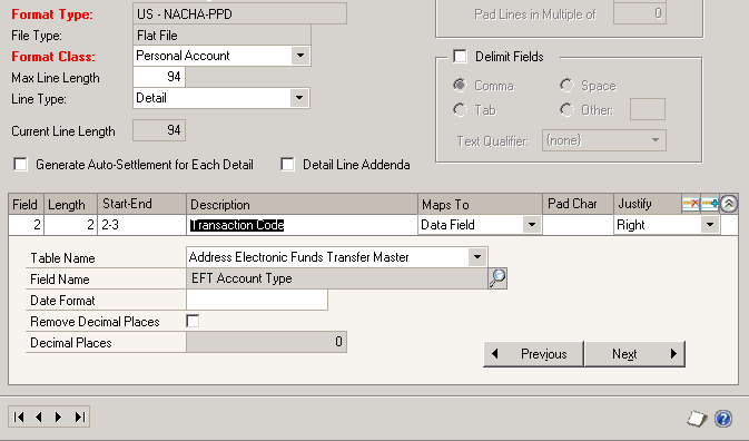

      ?In my EFT file format, the second field on the detail line is called “Transaction Code” It is defined as the “EFT Account Type” from the “Address Electronic Funds Transfer Master” table. Below is a screen shot. The vendor EFT setup includes a field labeled “Account Type”. Hope this helps!
      Sandy Righi
      Senior Programmer Analyst
      Howard Hanna
      Mayfield Heights OH
