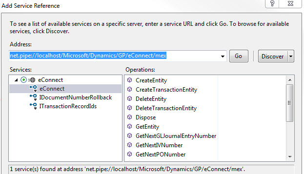

      I worked with WCF for a number of years (previous tour stops)Ā  so quite familiar with the technology, especially svcutil.Ā  I’ve discovered that eConnect is installed as a Windows Service which, in turn, hosts a WCF service with a couple of endpoints:
      WCF-based webservice for eConnect
      I have a simple class that includes this service reference and therefore I have the endpoints listed above available to me, primarily CreateEntity.Ā  I accept a Microsoft.Dynamics.GP.eConnect.Serialization.eConnectType object (which holds any/all eConnect data types).Ā  The object is serialized and sent to the eConnect WCF service, creating a client channel as needed.Ā Ā  All of my REST API calls for eConnect go thru this class.Ā  By encapsulating and abstracting away the WCF details, this just looks like any other method call.
      The secret sauce is in your app/web config where you specify the connection string for the desired PHARM database.Ā  In my case I have a production database and a test database we use for unit testing using the exact same code base.
