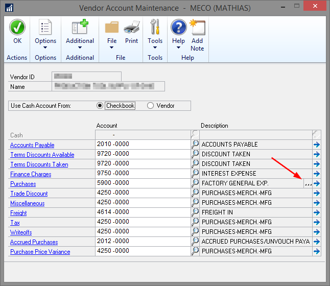

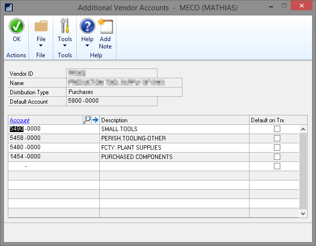

      The vendor does have a default account set, but it’s not the account I need for these items. Several of our most commonly-used vendors have multiple accounts that we assign line items to, for internal accounting and tracking purposes. I’ve added those to the additional vendor accounts window:
      However, this is an additional step I was hoping to negate by copying the account number from the original transaction.
