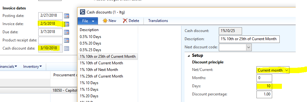

      We are trying to do the same thing but “current month” is using the following month instead?Ā  For terms 1% 10th, invoice date is 2/5/18 and should pull 2/10/18 as the cash discount date but it’s pulling 3/10/18.Ā  1% 10thSee image for an example.

    • JeneĆ© Demski
      February 28, 2018 at 9:47 AM
      Good questionĀ 1% 10th/25th = 1% 10th of the month (after the 15th of prior month) 2% 25th (after the 1st of current month).Ā  Also tried using the “next discount code” but that only seems to work if you miss the first discount.Ā  So I’m assuming there is no way to make this work without development?
