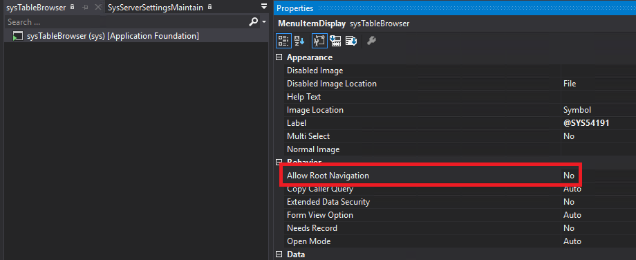

      It appears that the Allow Root Navigation option on the sysTableBrowser menu item display is set to No. This means that non-SysAdmins cannot directly navigate to this menu item without a context.
      I’m not sure what the best option going forward would be to a non-SysAdmin user, maybe creating a ‘dummy’ local extension so you can change this property?

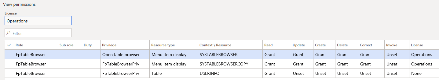

      3) Create/assign this copied menu item to a privilege/role (here is an example)

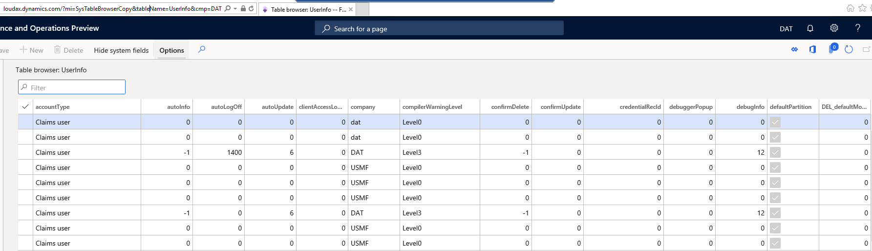

      4) When this is assigned to a user and they navigate to <RootD365FOEnv>/?mi=SysTableBrowserCopy&tableName=<tableName>&cmp=<companyId> they should see the table browser
      (for example to see the UserInfo table: /?mi=SysTableBrowserCopy&tableName=UserInfo&cmp=DAT)

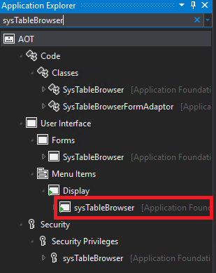

      I’m not sure if you want to try and access it through the user interface or through the AOT so I listed both options.
      The SysTableBrowser is not accesible through a path in the UI you can only get it to their manual URL manipulation using the syntax I listed in my previous post.
      In the AOT, you can find it by searching to sysTableBrowser and selecting the menu item to duplicate.
