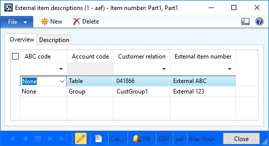

      As well as being able to assign the external part number to a specific customer account, you can also apply it to a customer group, which may facilitate applying the part numbers system wide.
      (The field is the “Item – customer group” within Sales order defaults on the customer record.)

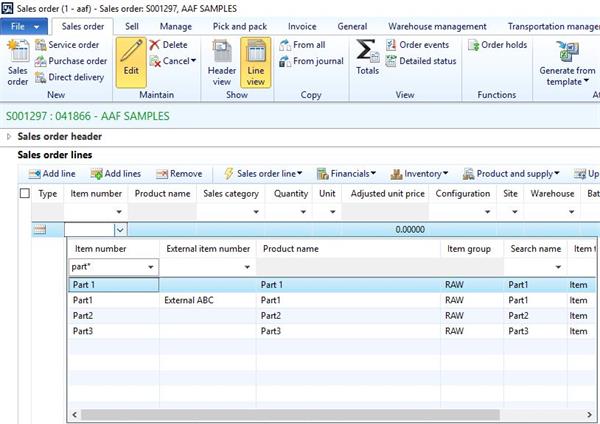

      How are you looking up the competitor part numbers? We have had to introduce a few developments to allow the sales team to reference and/or select by customer part number.

      Add the external part number to your part using a group relation, which is also assigned to your customers.
      Select the Item number drop down on the sales order, gives access to the external item number, as a searchable field (this was our dev).
      Our modification only gives access to the external item per customer relation, but i’m sure this could be adapted to show the relation per customer group also, as another column maybe.

      It is also possible to store external items on a group. Thus, you could make a single group, and add that external item group to all your customers, then add the competitor’s info to that single group.

      Navigate to Form: Sales and Marketing Module, Setup, Items, External item Description
      Create new record, such as: Code: COMP, Name: Competitor’s Items
      Click the External Item Description menu at the top of the form to navigate to the form that allows you to add rows.
      For Customers:
      Navigate to the Customers Detail Form.
      Navigate to Sales order defaults fasttab.
      Populate Item-Customer group field with your code from above: COMP
