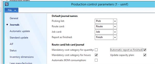

    • Colby Gallagher
      April 17, 2020 at 2:12 PM
      It sounds like you don’t have the Production Control Parameter -> Journals -> Automatic Report as finished ticked.Ā  Ā Also please confirm you’re not using a WHS / advanced warehousing warehouse, it doesn’t work well with this process.Ā  Ā  Worst case you can schedule a batch job at Production Control -> Periodic -> Production Orders -> Report as finished to roll through looking for orders with Remain Status = Report as Finished and post the RAF.Ā Ā

    • Greg Pope
      April 21, 2020 at 1:22 PM
      Thanks Colby,
      That seems to be the case. I checked the Automatic Report as Finished and a post to RAF journal was attempted. It errored out because it wants a license plate location but now I think I’m on the right track.
