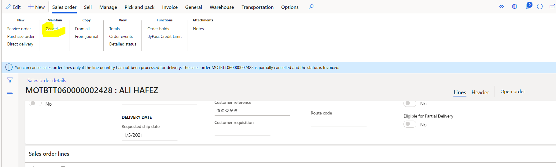

      We have a sales order of 10 lines and out of 10 lines we delivered and invoiced 6 lines and now 4 lines status is Open order and Header status is Open Order.

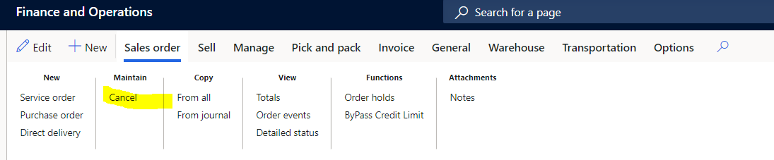

      Now I want to cancel all open order lines at the same time and make it header status is Invoiced.so I tried to cancel the option from the Action pane Sales order–> Cancel but its showing below message
      You can cancel sales order lines only if the line quantity has not been processed for delivery. The sales order xxxxxxxxxxxxxĀ  is partially canceled and the status is Invoiced.

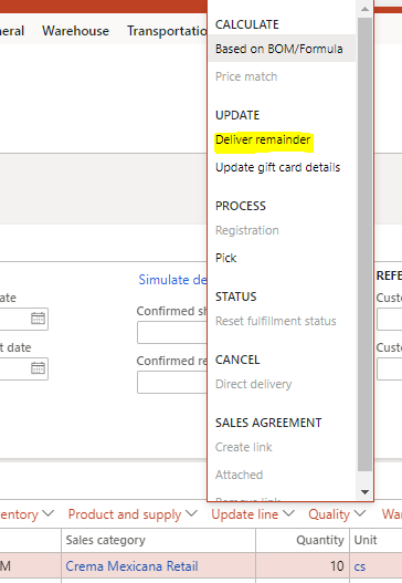

      We had the same issue at one point and used the ‘deliver remainder’ option to resolve it.
      Of the four lines you didn’t ship, select one and then click the ‘Update Line’ button. Select ‘deliver remainder’ and then set it equal to zero. This is pretty much telling the system you don’t want to ship these lines anymore.
      You would have to do this for each individual line but once you do this the order status should go to invoiced. If you ever wanted to go back and ship those lines, I believe you can just click in to the deliver remainder option again and update to restore the original line quantity.Ā

      Please find below the error message while canceling the open order sales lines.
      Abrar Ahamed
      Arla Foods – Saudi Arabia
    • Sarah Gabriel
      March 3, 2021 at 12:34 PM
      Abrar,Ā
      This is just an information message and not a hard stop. The message states the order is partially cancelled and the status is Invoiced. The order should have an Invoiced status now. We see this message during our cancellation process and it doesn’t stop us.

    • Colby Gallagher
      March 4, 2021 at 2:15 PM
      You’re doing the correct process, and is exactly correct.Ā  When you click “Cancel” button on the SO header, it tries to cancel all lines on the sales order.Ā  It obviously can’t cancel lines that have shipped, but it does cancel lines that were not shipped / you have not started the shipping process against.Ā  So the info log is telling you this, it couldn’t cancel the shipped lines, but it canceled everything it could and now the SO is in status “invoiced”.Ā
