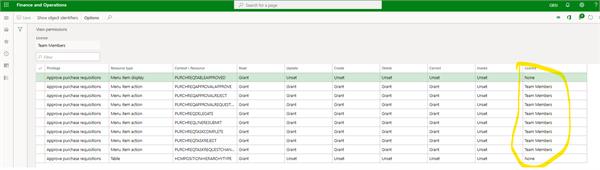

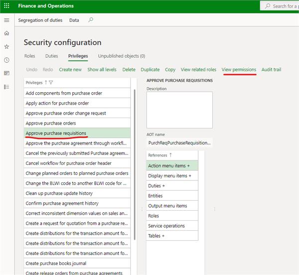

      The easiest way to check requirements for licenses is to go to;
      System Administration -> Security -> Security Configuration
      Select privileges/duties and search for the action you want
      Then select view permissions
      Scroll the the right of the new window and you will find the licx requirementsĀ
