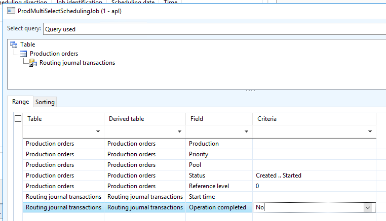

      I have batch job to schedule Forward from previous job – reschedule all Started and Scheduled production orders. However, I don’t want to reschedule a production order operation that has already started (time has been posted to that operation) but not completed. If a prior operation has been completed and I choose to rescheduleĀ Forward from previous job, how can I prevent the next operation from rescheduling if it has already been started in the past? In the example below, rescheduling will result in the Op 20 start date moving to the current date but it should stay as it is already started on 3/27.Ā

      Can’t you just add a criteria to your query range? Maybe you could filter out the completed operations or by time/date for operation start.

      Yes, I would like to have criteria to do the following but don’t think it can be done with a filter. I think it will need to be a custom query.
      IF
      After the last completed route operation, the subsequent route operation is scheduled to start <=TODAY
      ThenĀ Ā Ā Ā Ā
      Do not reschedule
      ElseĀ Ā Ā Ā Ā Ā
      Reschedule forward from today
      ENDIF
