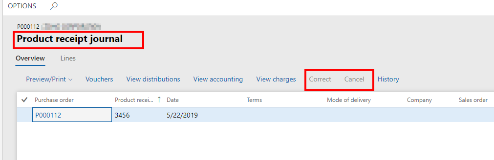

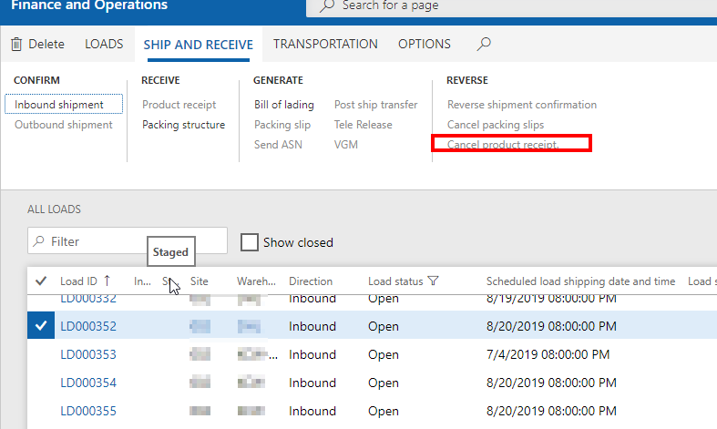

    • Andrew Lencsak
      June 18, 2019 at 1:46 PM
      Hi Jeff,
      On second checking, the Correct packing slip option may not be fully available with Advanced warehousing. You can only see that option from the Product receipt journal screen either directly from the PO or the journal form, you don’t see this option on the Load, only the Cancel Product receipt option:
      When using the correct or cancel options, the inventory would have to be in the location/license plate that it was registered against so may involve some location/LP transfers if Putaway work has already been completed. These two blogs are pretty good reviews of this process:
      https://timsaxblog.wordpress.com/2016/02/22/why-you-cant-reverse-a-purchase-registration-in-whs-in-ax-2012-r3/
      https://www.sikich.com/insight/how-to-correct-purchase-order-receipts-in-dynamics-365/
