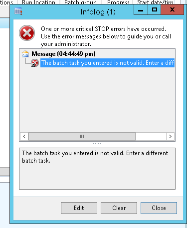

      I am trying to recreate theĀ “Named user license count reports processing” using a generic user account instead of a specific user however, every time I try to link the class “SysUserLicenseMiner” class to the new batch task I encounter the following error message:Ā
      “The batch job task that you entered is not valid. Enter a different batch task.”Ā
      Does anyone know how to recreate this batch job?

      If you can create a batch job in the AOT then enter the following:Ā Ā SysUserLicenseMiner::createBatchJob();
