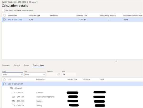

      Hello everyone, and thanks in advance for any insights anyone may have.Ā  It is very much appreciated.
      This question overlaps with Power BI, but I thought I’d post here first.Ā Ā
      I’m trying to be able to build a Power BI report that is able to show an Item Number’s Cost per Cost Component at the lowest BoM level.Ā  Within Dynamics 365, an example of the data I’m trying to get within Power BI is attached and I tried to past it within the body of this dialogue as well.
      The only table that I’ve been successful in finding within Power BI having to do with Item Cost is theĀ InventItemPrices table.Ā  However it doesn’t provide any breakdown at the Cost Component level.
      Any ideas on if there is a source available that I can pull from D365 within Power BI that would provide the same information as in the attached screenshot?

      I cannot actually see your screen shot, but the detail costs are held in BOMCalcTrans.Ā  There is a field on InventItemPrice called PriceCalcID that links to BOMCalcTrans.

      Thanks Kevin, greatly appreciated.Ā  I’m unfortunately not seeing that table as an option within Power BI šŸ™Ā  I’ll have to investigate why it’s not appearing within Power BI for me.

      I believe technically the “tables” that PowerBI allows access to are actually what D365 FnO calls Entities. Not all tables within D365 FnO have corresponding entities. However, you can create custom entities to fill that gap.Ā
      Instructions can be found here: Data entities overview – Finance & Operations | Dynamics 365

      I ll just comment real quick on why you don’t see this table (BOMCalcTrans) in PowerBI. The tables you see in PowerBI, assuming you are using Odata to connect are not the SQL tables from which the system runs, what you see in PowerBI are data entities that can be related to one table or multiple tables in the SQL database. To be able to see this table BOMCalcTrans you will need a developer to custom create a dataentity set it to public and link it to the data from this SQL table BOMCalcTrans.
