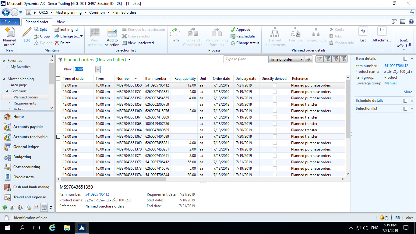

      Recently I came across an issue. In Planned Orders we have Time of order and Receipt Time. I know that the receipt time is set in master plan parameters but I do not know where the time of order is set?
      lets assume that the receipt date is 10:00 AM, if I run MRP at 11:0 AM (Lead time=0) the order is placed at the same day or it will be moved to tomorrow?
      what are the other businesses behind these two times?
