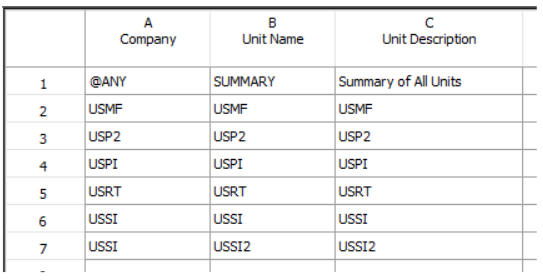

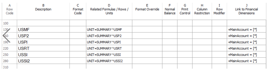

      2. The more common way is to use a Reporting Unit restriction on the row that is specific to the branch of the Tree for the particular Entity.Ā
      As an example. Tree as follows: (see MS1 (Tree))
      Reporting Tree
      Ā Row:Ā (see MS2 (Row))
      *If possible do not use the same dimensions between the Tree and the Row.Ā

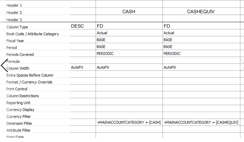

      Ā Row DescriptionColumn:Ā (see MS3 (Column))
      Reporting Column
