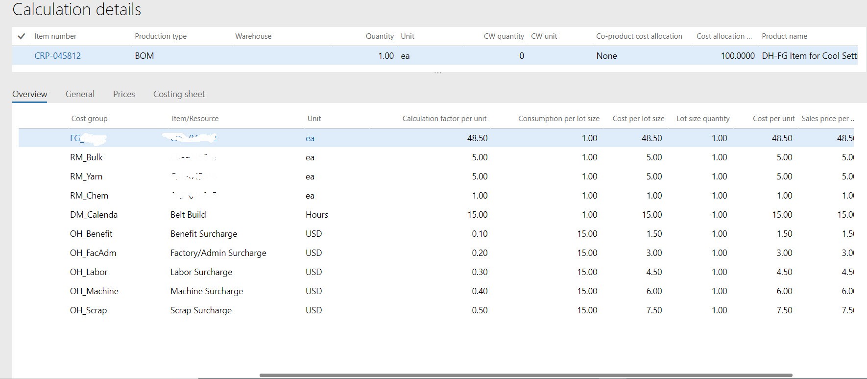

    • John Balmaceda
      March 21, 2018 at 10:48 AM
      Agreed, the costing sheet is the best way to break out these costs for manufactured items.Ā Ā
      You will be able to see the costs once the BOM is rolled up. See example.
      Example of rolled cost
