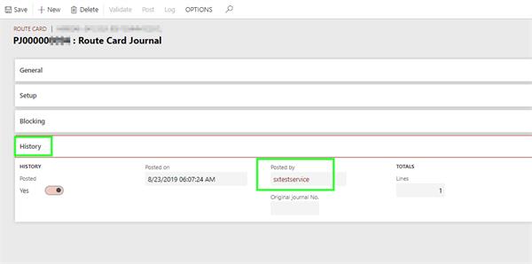

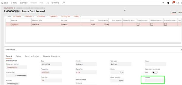

      You typically would not use both Route cards and job cards together. You can capture the WHO in route cards and operations scheduling, There is the user ID for who posted the Route card that is recorded on the Route card header if that is the person doing the activity or you can capture the Worker account in the Route card line details if you are not auto-posting them, by recording this value when the Route card is created but not posted yet.

      1.) If you’re going to capture the worker on the Route card journal line, you need to create Worker records for your shop floor employees, they don’t need to have an AX userID.Ā
      2.) To get the worker onto the journal line and the corresponding Route transaction, you can either:
      • Have some sort of manual process, IE turn slips into a data entry office that keys the journal. You can key journal lines against many production orders / operations at once.Ā  Also, you can personalize the Worker field up to the grid for easier entry.Ā Ā
      • set the workers up as Resources of type “human resources”, and then schedule against them, and then the Worker field will get populated automatically when the journal is posted based on the resource (worker) that was scheduled against.Ā
      3.) The user ID that posted the route card journal does not get posted to the corresponding route transaction record.Ā  If you do use the Worker field, it does get posted, then you can easily review data at Production control -> Inquiries & Reports -> Production -> Route Transactions.Ā  You’ll need to do some personalization, but this will have all your quantity and time data in it.Ā  Note that a row is posted for Time and a row for quantity for the same line from a Route Card journal.Ā Ā
