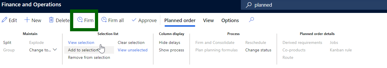

      Thanks for your feedback, that process would work for us, but what do you mean by “firming to a journal”?
      When firming I don’t see this option:
      Thanks again!

    • Kevin McLean
      June 15, 2021 at 11:11 AM
      Sorry – that’s what happens when I try to multi-task.
      That should have read, “Firm a planned purchase order to a journal status”.  I assumed you were using master scheduling.  You may not be.

    • Alexandra Cadet
      June 16, 2021 at 8:49 AM
      That’s what I had read indeed!
      The part I don’t get is “into a journal status”.Ā  Is that possible?
      Alexandra Cadet
      Camfil
    • Kevin McLean
      June 16, 2021 at 11:12 AM
      I’ve never tested it, but probably not.
