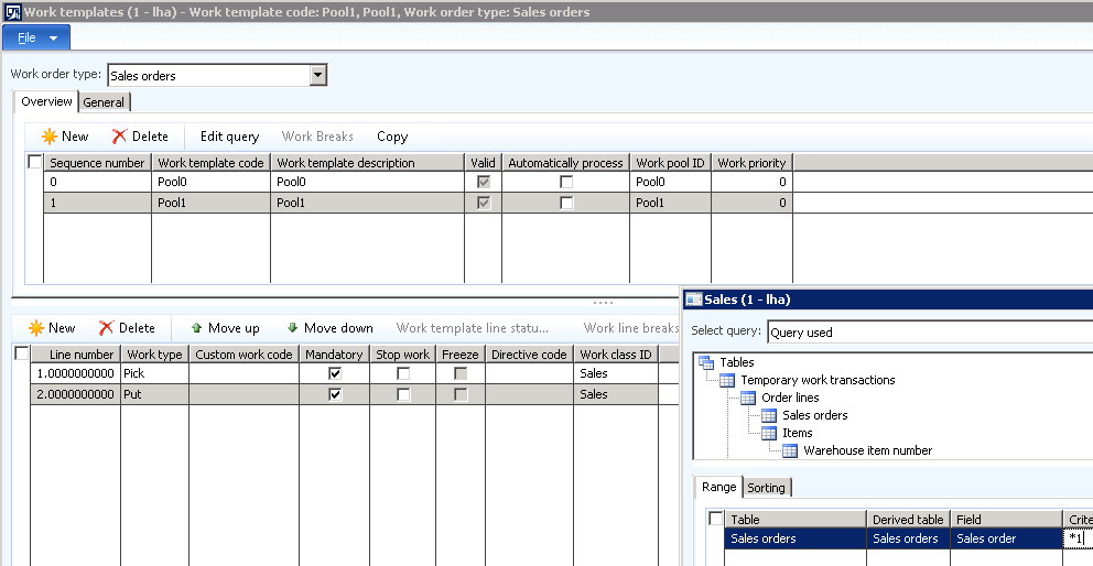

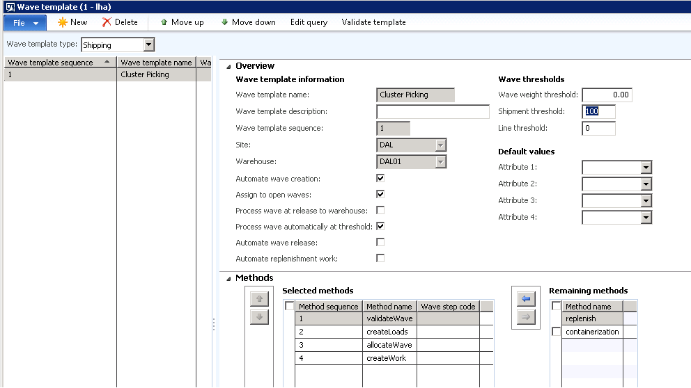

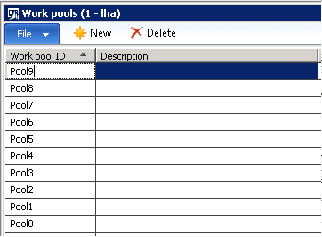

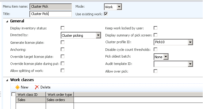

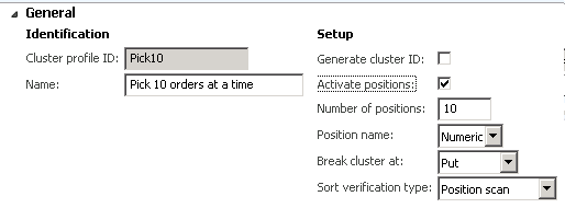

    • Daniel Zook
      October 15, 2020 at 8:51 AM
      Before I get too far into entering orders to test this setup, here are screen captures showing the configurations that I created in my attempt to follow your suggestion.Ā  If you have a minute, please review these and confirm that it is setup the way you were thinking, or at least that I didn’t miss something critically important.

      Menu item:
      Menu item
      Cluster profile:
      Cluster profile
      Work template example:
      Work pools
      work pools
      Wave template
      Wave template

    • Colby Gallagher
      October 15, 2020 at 2:55 PM
      Looks good!
