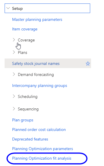

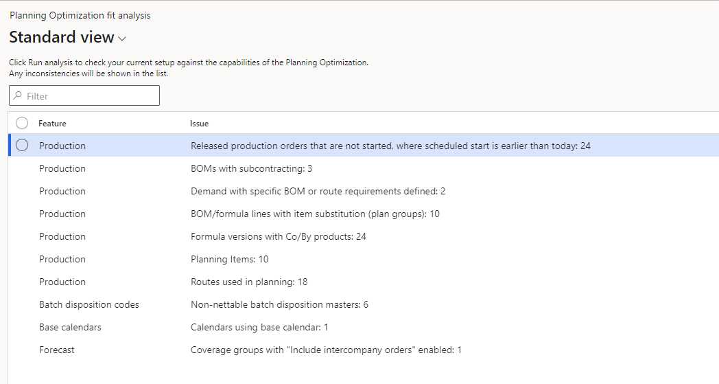

      The fit analysis in D365 has been helpful as well, if you do turn it on you will lose some production explosions currently from testing.Ā  The fit analysis will tell you what the planning optimization won’t support when you run it as well.
