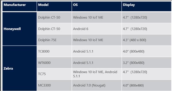

      Even though it’s called the mobile app, you will find most companies use scanners and tablets rather than phones.Ā Here is a list of devices Microsoft R&D uses for their testing which are scan guns.Ā
      Here are other options that are commonly used:
      – Zebra: TC20, TC25, TC51, TC56, TC70, ET50
      – Honeywell: CN80, EDA70, EDA60, CT60
      – Panasonic: FZF1BCC
