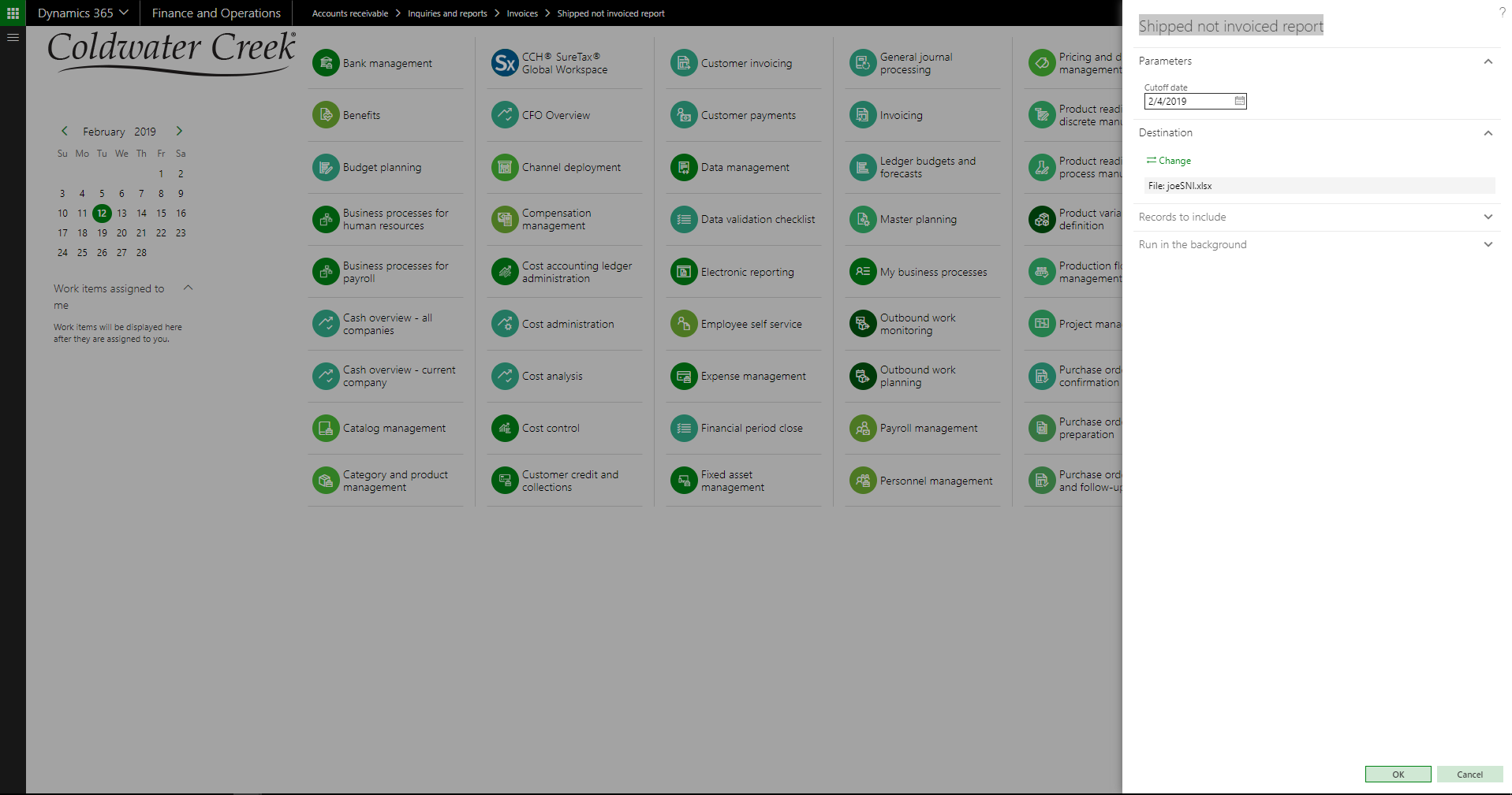

    • Joe MacPherson
      February 12, 2019 at 5:37 PM
      Assuming that you’re using Dynamics D365 F&O then try
      Accounts Receivable > Inquiries and reports > Invoices >Ā Shipped not invoiced report…
      Shipped Not Invoiced rpt

    • Arush Kuthiala
      February 13, 2019 at 9:47 AM
      The Report has a cutoff date which allows you to back date the information.
