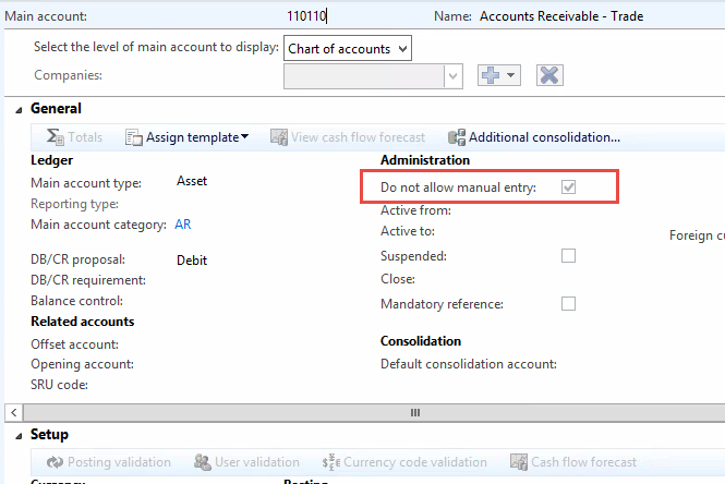

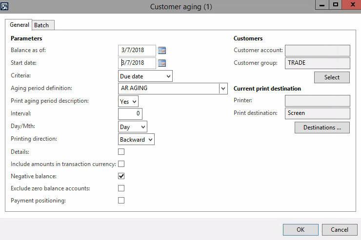

    • Stacy Black
      March 9, 2018 at 9:57 AM
      Andre,
      Can you provide a snapshot of your Aging report criteria?Ā  Also have you confirmed that the AR account is locked for manual entry and that your posting profiles are setup correctly?
      Stacy Black
      Senior Application Consultant
      MCA Connect
      Denver CO
    • Andre Juneau
      March 9, 2018 at 10:58 AM
      ?Here’s a snapshot of our aging criteria …
      Here’s a snapshot of our Posting profiles … (note … there are currently no customers assigned to the RET Customer group).
      And finally, here’s a snapshot of the AR MA 110110 Setup.
      Andre Juneau
      Bush Brothers & Company
      Knoxville TN
    • Stacy Black
      March 12, 2018 at 10:00 AM
      Hi Andre,
      A couple other items that I notices were:
      Your Criteria was set for Due date, this could bring an imbalance since some customers may not have the same due dates.Ā  A better method would be to use Transaction date.Ā  This is the date the invoice was posted to the GL as well.
      Payment positioning – if you have anyone who makes overpayments or payments on account you will want to include that amount in your balance as well.
      Another item recommend as part of your month end is to run the “reconciliation” reports in the General ledger (General ledger>Ā  Reports> Reconciliation).Ā  These reports will show you any transaction that has not properly passed from the sub ledger to the GL and vice versa.Ā
      Reconciliation
      In each of the areas (Customer, Bank, Vendor, etc)Ā  you set your monthly date parameters and choose your posting profile.Ā  Make sure you select for differences only so you only see those that are issues.Ā  Your goal would be to have a report that comes back blank.
