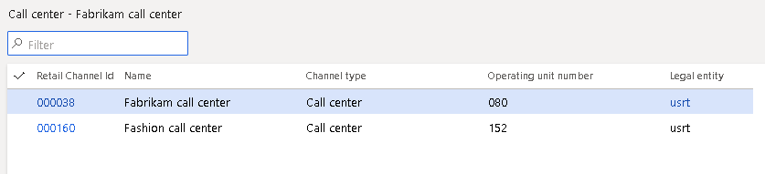

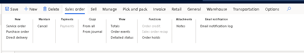

      In the demo environment I need to try out the call center sales order features as part of the fit/gap analysis.Ā  Unfortunately, the “complete” button is missing, and the payments and sales order recap buttons are disabled.
      Here is what I’ve tried so far:
      – Confirmed the Call Center license configuration key is enabled
      – Confirmed my user account has the System Administrator role
      – Confirmed my user is assigned to the channel users in the 000038 “Fabrikam call center” call center
      – Tried creating the sales order after looking up two different users in the customer service form (one existing, one new)
      – Opened a ticket with Microsoft.Ā  They were not able to reproduce the problem in their “internal environment”.
      Does anyone know if this is a known-issue with the Demo environment?Ā  Or how to fix it?

    • Daniel Zook
      December 30, 2020 at 9:57 AM
      Microsoft suggested using USRT (instead of USMF, which is the company I was using), and that works.Ā  Just FYI for anyone else in this predicament.
      Apparently the reason for this is because the call centers list is company-wide, but each call center is linked to a particular company.Ā  I missed that…Ā  :-/
