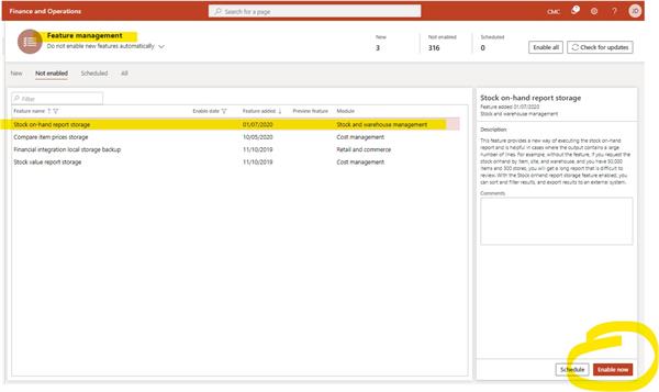

    • Jonathan Howe
      September 18, 2020 at 10:39 AM
      You need to find the “Feature Management” workspace and enable from there. If you are implementing you should seriously consider turning on features relevant to you region as it is a lot harder once you are live to go through the necessary testing. However, I can appreciate that during an implementation you may have your hands full already. Good luck.

    • Tim Stutzman
      September 18, 2020 at 11:19 AM
      Thank you for your help!Ā  I enabled the feature and tried to export via data management to both excel and BYOD and it exported 0 lines.Ā  Is there something else that I have to do?
