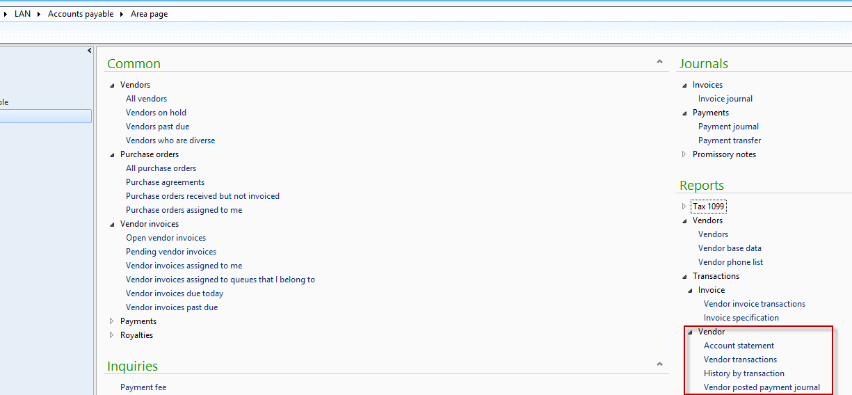

      We are using Microsoft Dynamics AX 2012 R2.Ā  In the accounts payable module, under reports – Vendor, is a report called AP Payment Report.Ā  This report seems to only show AP Payments paid by check.Ā  Is it a bug that this report doesn’t show payments made by other methods such as ACH?Ā  Thanks!

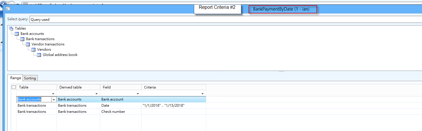

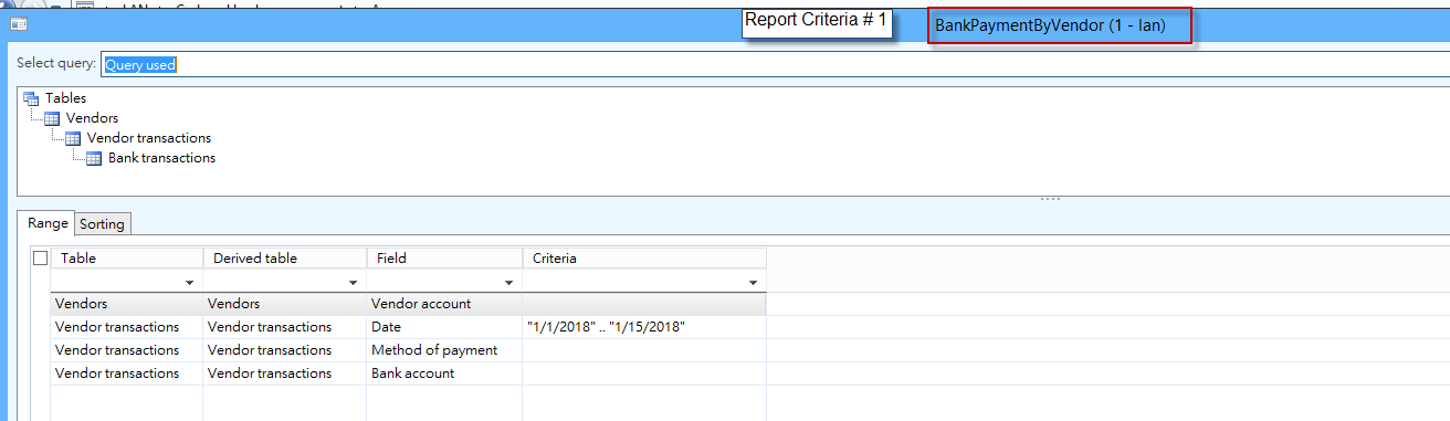

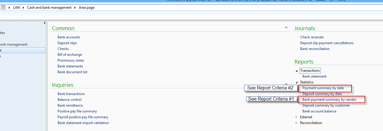

      We use AX2012 R3, and the AP reports are not that great.Ā  You might try running reports under Cash and Bank Management.Ā Ā The report I have used in the past is the “Bank payment summary by vendor.”Ā  I have added a screen shot of the Report Criteria I had to add to get the information I needed.
      While this report does notĀ list the Method of Payment, the Bank Account NameĀ or the Payment Reference numberĀ can be your indicator. We have all of our MOPs in a different bank. Each MOP hasĀ a unique set of Check numbers, which also helps us identify what group a particular vendor is under.
      You can also run the “Payment summary by date” report. You can select certain bank accounts or all.Ā  I think either one of these reports will return the information you need.

      What is weird is that in R3, there isn’t a report with that title for me to select.Ā  I tried to run the History by transaction report because you can select a General Ledger number. However, the payment information is not provided.
      Maybe an SQL report would be easier to create and run??Ā  I would be curious to hear what your resolution is..
