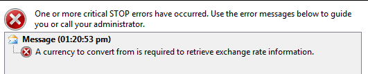

      ?An AP user is getting this error msg that we haven’t seen before when trying to post an invoice:
      Ā Ā Ā Ā  Error msg when posting AP invoice
      Any suggestions for resolving this error?

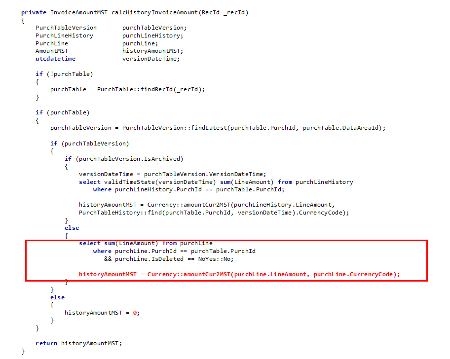

    • Richard Plodzik
      January 4, 2019 at 11:35 AM
      My company was sporadically receiving this error also. We are using AX 2012 R3 CU13.
      We traced it to a Microsoft code bug in the method calcHistoryInvoiceAmount of the PurchTableDocument class:
      In the outlined code block – the red highlighted line is causing the issue because the purchLine.CurrencyCode will always be blank(null) due to the select statement preceding the line.

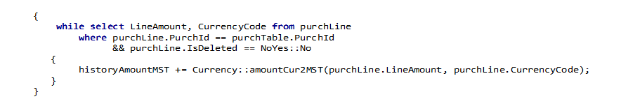

      To correct, we replaced the highlighted block of code with:
      Richard Plodzik
      The Paslin Company
