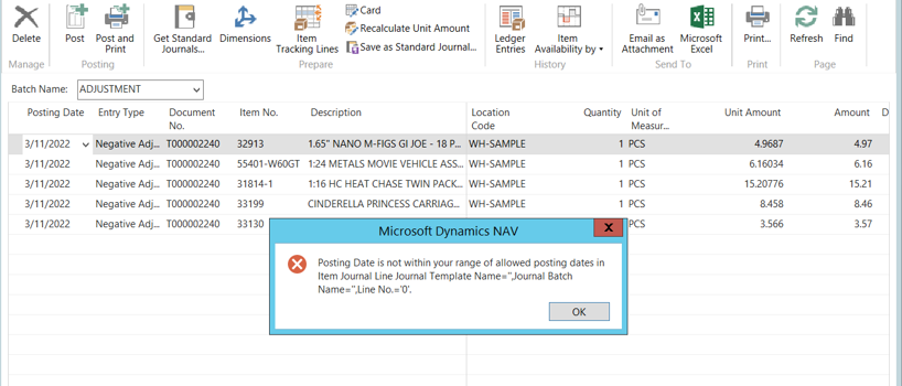

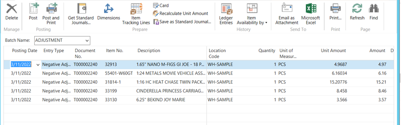

      There is a item journal that the user is trying to post.
      But error message is flashed on the screen where we do it.

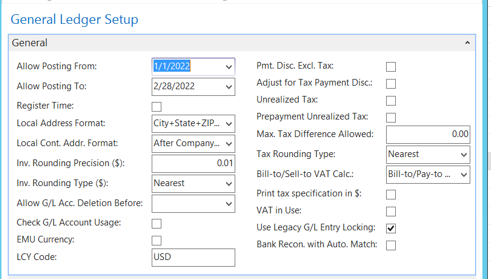

      At the same time our General Ledger Setup where posting dates also can be specified, shows up in this way.
      The General Ledger Setup’s allow posting from and allow posting to is pointing from 1st Jan 2022 to Feb 28th 2022.

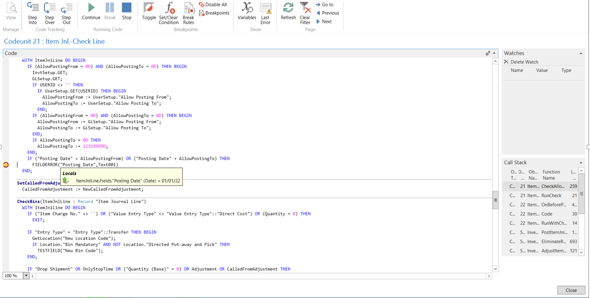

      I did debug but it takes me to itemjnl code, see the below screen
      I have no idea why and what posting dates we need to set.
