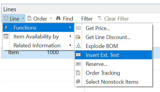

      I agree with Dave’s answer.Ā  Another option is to use Extended Text if you want the information to show up on an order line, but it will require extra steps.Ā  You can enter the pallet information as Item Extended Text on the Item Card.Ā  Then when entering sales orders, use the Line menu drop-down, select Functions and Insert Ext. Text.

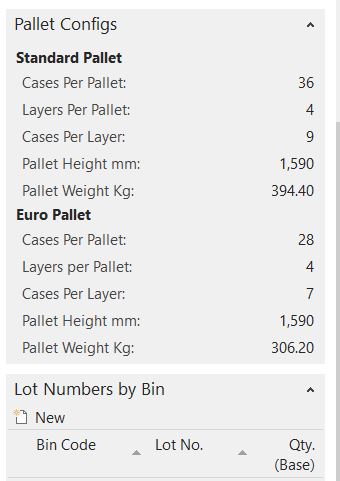

      What we have done is to set up new fields on the item table, then use a factbox to look at this data in the sales order.
      As this is also on the item card, we don’t have to be entering a sales order to view the info.Ā  We don’t however use ALT UOM’s so I can’t tell you how this would handle them.
