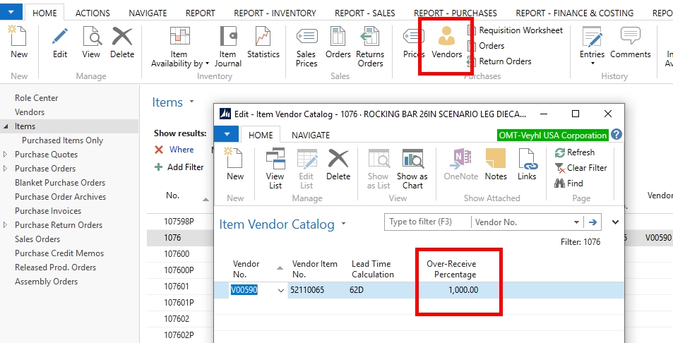

    • Brian Kooshian
      June 14, 2019 at 8:45 AM
      I’m not sure if this is what you are looking for, and I don’t know if this is due to a mod or not, but In our version of NAV 2015 there is a button on the Home tab of the Item Card called “Vendors”. This takes you to the “Vendor Item Catalog” where you will see a table which allows you to enter over-receive percentages for the item by the supplier.

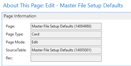

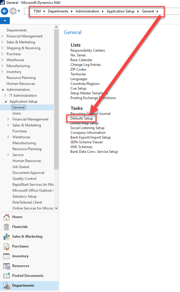

    • Gregory Alford
      June 17, 2019 at 10:16 AM
      Screen Shot for Defaults Setup

    • Gregory Alford
      June 19, 2019 at 4:21 PM
      I believe this is part of the Cost Control starter database.
      Page and Table information for defaults setup
