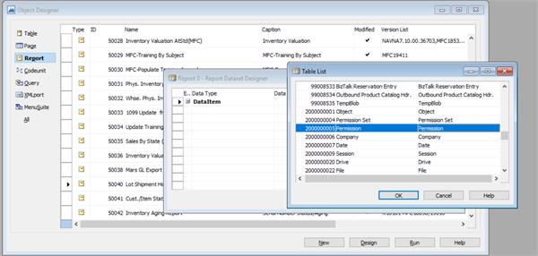

      October 25, 2019 at 2:22 PM
      The Session table is a virtual table and cannot be accessed from Object Designer, although you can create a report to read it.
      <<click image to enlarge>>
      report session table
      NAV Virtual tables:Ā Ā https://docs.microsoft.com/en-us/dynamics-nav/virtual-tables
      List of Virtual Tables in NAV:Ā Ā https://community.dynamics.com/nav/b/tharangacnavblog/posts/list-of-system-and-hidden-tables-microsoft-dynamics-nav-2018

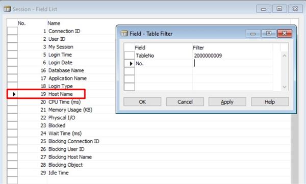

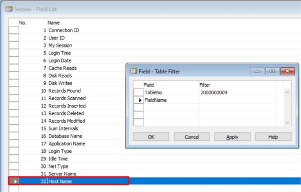

      Field 19 is Host Name in Session Table.
      ** How to Check that –Ā
      1. Add ID in Form 6218 and Run form with Filter – Tableno =Ā 2000000009.
      Information –
      Field 19 only exists in SQL Database not for the native update as shown below. In the Native database, Host Name is Field 32.
      I will recommend to restore the backup in a SQL Server database and let user access it.
