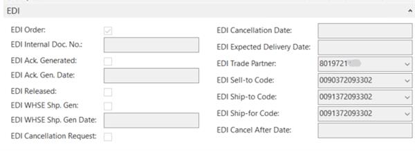

      This is the EDI section of the Sales order manually created before posting:

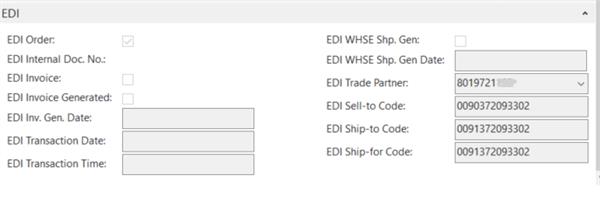

      This is the EDI section of the posted sales invoice:

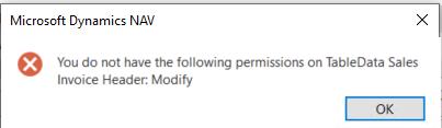

      And this is the error when we attempt to enable EDI invoice on the posted sales document.
