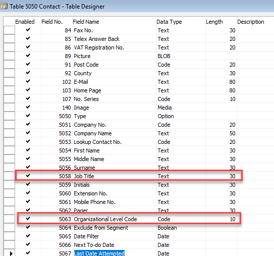

    • Kris Ruyeras
      April 12, 2018 at 6:25 PM
      It doesn’t help either that there is a field within the Contacts table called “Job Title”. Confusing? Yes. LOL
      Kristoffer Ruyeras
      Director of Business Technology
      Seattle, WA
      April 13, 2018 at 9:24 AM
      ?Since the field does indeed exist, aĀ develop can add it to the Contact Card.Ā  No need to keep it hidden away from use!Ā Ā  I think it is hidden, however, because it was meant for integration with Microsoft CRM.

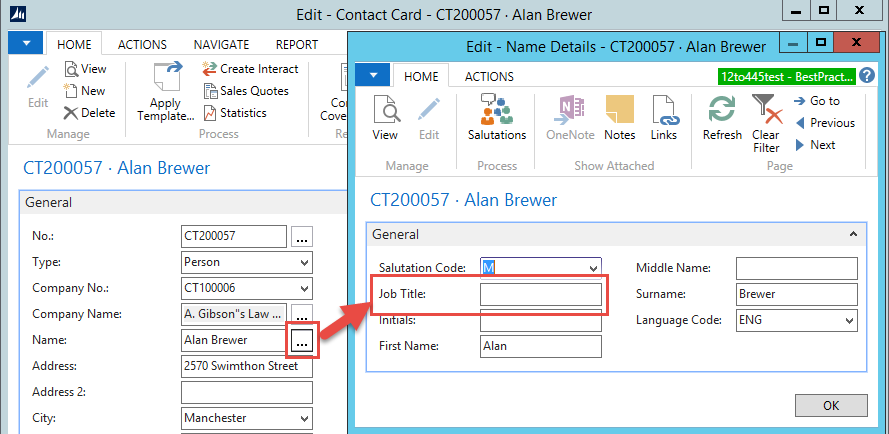

    • Lisa Doran
      April 16, 2018 at 10:04 AM
      The Job Title can be found on the Name Details screen related to the contact, which can be found by clicking on the Ellipsis next to the Name field.
