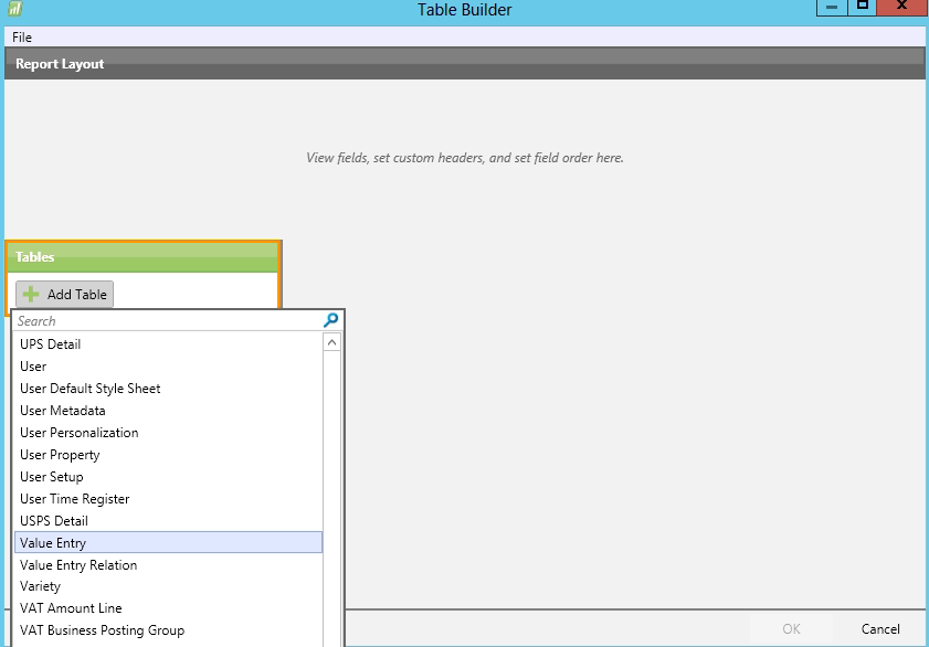

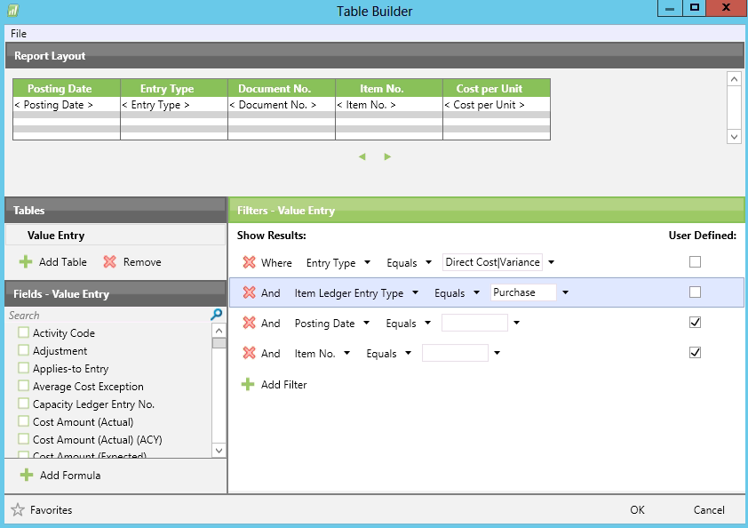

      To add to Rick’s suggestion, you can retrieve old cost information with Jet Express, although it is some effort.
      To get started, a basic setup could be as follows
      Build a table with “Value Entry” table.
      For fields, you will want (at minimum) Posting Date, Entry Type, Document No., Item No., and Cost per Unit. This can be filtered to where “Item Ledger Entry Type” = “Purchase” and “Entry Type” = “Direct Cost|Variance”. You will also want to have Posting Date and Item No. left as user defined.
      I would suggest running the report for a set of items over specific date ranges. The result will something look like this
      The above is a hypothetical situation where item 12345 was $1.00 standard cost today and $2.00 tomorrow, with the actual cost being $1.50 and variances -$0.50 and +$0.50 respectively. Thus, Direct Cost + Variance = Standard Cost.
      You can then make Ā a pivot table summing the variance and direct cost by date, document no., and item no. This will produce the standard cost on a particular purchase invoice for a particular item at a particular date.
