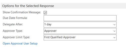

      The workflow is set as:
      What we would like to see is:
      If the User 1 does not approve request within 1 day (time starts when approval request is generated), it is automatically delegated to User 2.

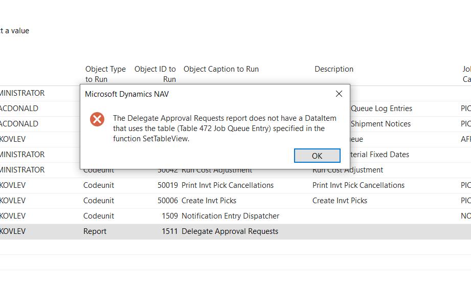

      In NAV 2017, I was able to add a Job Queue Entry for report 1511 to automate the delegation process.Ā  We chose to set the reoccurrence frequency to 1440 minutes, or every 24 hours.Ā  Hope this helps!
      John Hawkins
      Oilfield Software Solutions, LLC
    • Tetyana Yatsenko
      June 22, 2020 at 7:44 AM
      Hi John,
      we did as you suggested and here is the error message:
      Can you please recommend how to resolve this?
