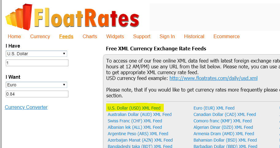

      1) Find the Feed: I went onto FloatRates.com and found the link to the .XML feed for the daily USD:

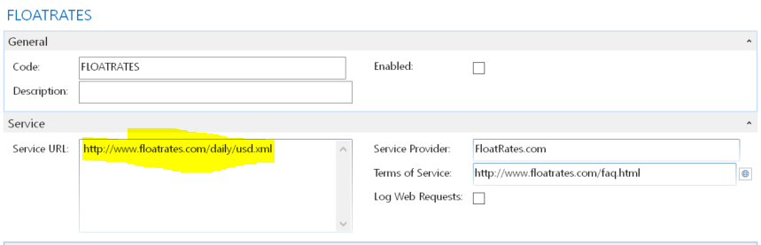

      2) Create a New Service in NAV: I opened up NAV, went to the Currency Exchange Rate Services page and created a new one called FLOATRATES and pasted in the feed into the Service URL:

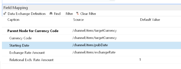

      3) Map the Fields: I used the nifty AssistEdit buttons in the “Field Mapping” FastTab to pick the appropriate fields for my mapping:

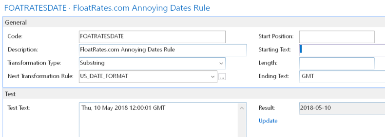

      4) Deal with the Dates: Dates are annoying since this feed uses a format that looks like “Thu, 10 May 2018 12:00:01 GMT”. Gah. So what I did is created a new Transformation Rule called “FLOATRATESDATE” (kinda rhymes) and did something like this:
      Few notes on this: the “Starting Text” is a space, not blank. And the “Ending Text” is a space followed by ” GMT” so that it snips off that stuff. Also, make sure you have a Next Transformation Rule that reformats the date into the US date format.

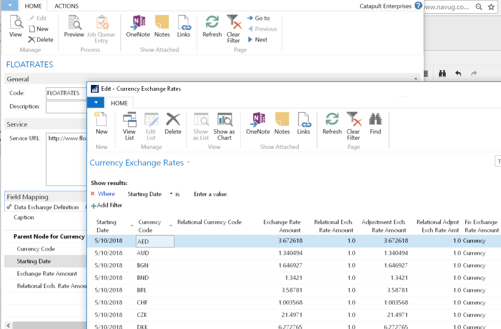

      5) Preview and Confirm: Simply click the Preview button on this new service and revel in the glory of NAV’s beautiful data exchange engine:

      When you hit Preview and the Currency Exchange Rate table is blank, then it means you’re not properly configured.
