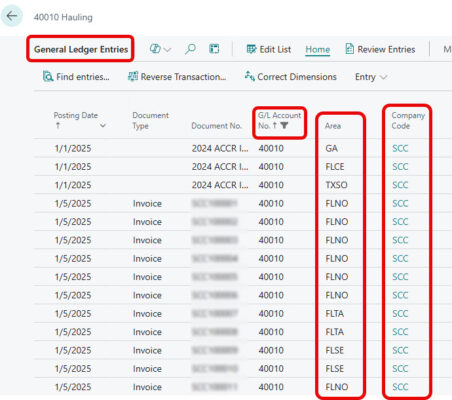

    We moved from GP to BC about 10 months ago. I’m more on the technical side of things, and I’m sometimes told my credits don’t always match my debits, but we had several discussions around this.
    In our scenario, we have several companies and locations, so our GP G/L accounts were similar to yours: <natural>-<company>-<location>.
    A couple of concepts that we struggled with was that the concept of distributions from GP really goes away in BC and is more or less replaced with dimensions. In BC, our chart of accounts was greatly simplified as we now only have the natural account. Each transaction line gets assigned a company dimension and an area dimension. Hopefully your partner has some experience with GP – ours did not, so explaining a few things we did in GP was sometimes challenging.
    We also took the opportunity to rebuild the chart of accounts, which was really worth it to simplify and standardize accounts that had evolved over the last 20 years of changes in business practices.
    To illustrate what the GL entries look like in BC, here a quick look at how they look for us with the dimensions replacing the 2 segments of the GP GL account numbers:

      Thanks for your explanation Jeff! I do think that we have approached our natural accounts and dimensions in a similar way to your screen shot. We have 1 utility account and the dimensions are the department and location. I think the way I illustrated it made it look like we had a segmented account. The utility account is the natural account and then we have dimensions set up for dept and location. I hope that clarifies it.
      My issue is the way some of our departments work, the department & location for the distribution account can not match the breakdown/statistical account department & location.
