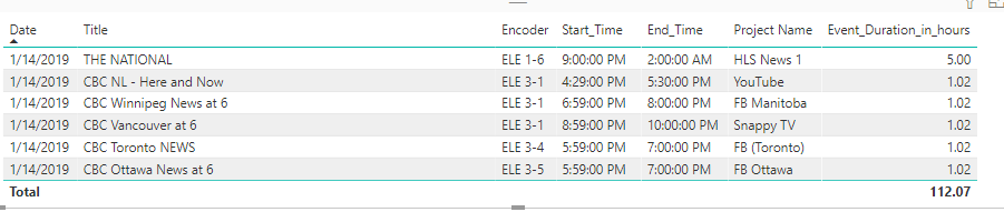

      I’m hope someone can help me with this formula. I don’t understand why it’s adding an extra minute for the calculations. The time should only calculate to 1.01 not 1.02.
      This is my formula

      Hi Joanne. Your calculation is showing decimal hours, not hours and minutes; the calculation looks correct, but the rounding to 2 decimal places I’m guessing is the source of the confusion. You can get the correct number of minutes in a calculated column with “Duration in Minutes = DATEDIFF( Shows[Start_Time], Shows[End_Time], MINUTE )”, then use “Duration 1 (Hours) = ROUNDDOWN( DIVIDE( Shows[Duration in Minutes], 60 ), 0 )” and “Duration 1 (Minutes) = Shows[Duration in Minutes] – ( Shows[Duration 1 (Hours)] * 60 )” to get the whole number hours and minutes. Hope this helps. Greg

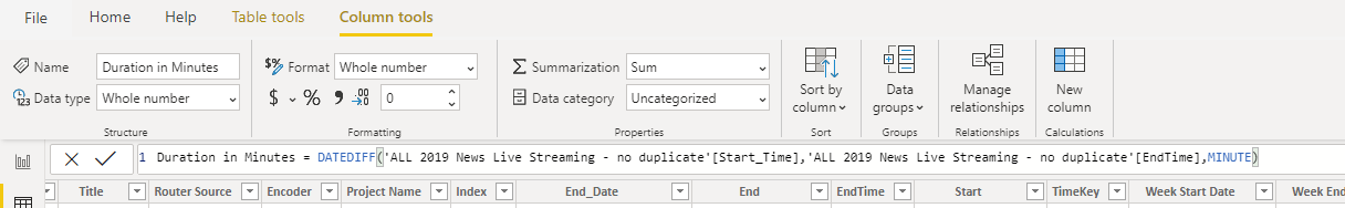

    • Joanne Osborne
      April 21, 2020 at 2:00 PM
      Hi Greg,Ā
      I’m so new to power bi.Ā
      Would this be two different calculated columns that I need to create.Ā
      I created the Duration in Minutes column but I’m a bit lost now as to the rest of your formula do I create another calculated column?
