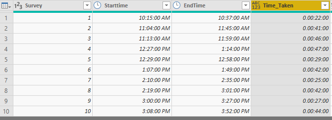

      Hi community,
      I have a survey data with time taken to complete the survey. I am trying to plot this information to show what is the average, max and min time taken to complete the survey. I want to create measure in power bi but I couldn’t find sample DAX formula for this.
      Any help will be much appreciated.
      Jag

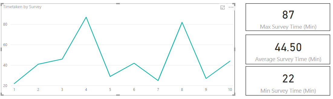

      As mentioned by Tuhin, I also believe this is not a time series analysis you want to accomplish here. Now if I understand your need clearly, the average, max, and min you are looking for is the aggregated value based on the computed time taken. If my assumption is correct then you could create something like this:

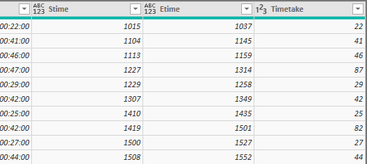

      However, this may not give you the expected output. What I did in the alternative is to convert all time to ordinary number, and calculate MIN, MAX, AVERAGE from the new field, and here’s what I get:
      Hope this help!
