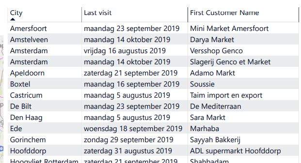

      I need to change from :
      maandag 23 september 2019” formaat to “23-09-2019”Ā Ā
      although I have this format “23-09-2019”Ā  Ā in the original table but when I make a report it turns toĀ “maandag 23 september 2019
      is there any way to do so?
      this photo shows how the report in power BI shows the date>

      Hi !
      Select [Date] column from table view on right side -> Click Column tools tab -> Specify Format options for [Date] column
      Your visual will reflect newly formatting changes.

      November 20, 2019 at 3:34 AM
      Thank you very much
