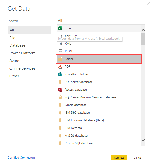

      If you are getting a new file each day for just that day, then you need to change the source dataset from a file to a folder.Ā  Ā PowerBI will iterate through all of the files (and folders) in the source folder, and append all of the files together.Ā  They you build your report from that new query.Ā  All you have to do to refresh the report is then just drop in the new file each day into the folder, and hit refresh.Ā  If you store the folder in Onedrive for buinsess, then the Power BI service can automatically refresh this data, so you don’t even need to open the desktop tool.

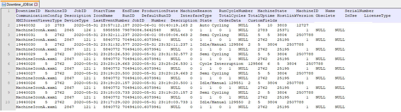

      My project is to calculate the production OEE Indicator, for which I need to collect information from 2 different locations / files:
      Downtime Injector (.txt file) – Injector monitoring system, where I collect all types of stop and restart events, production cycle, among others:
      I use the StartTime fieldĀ as a reference for incremental update.

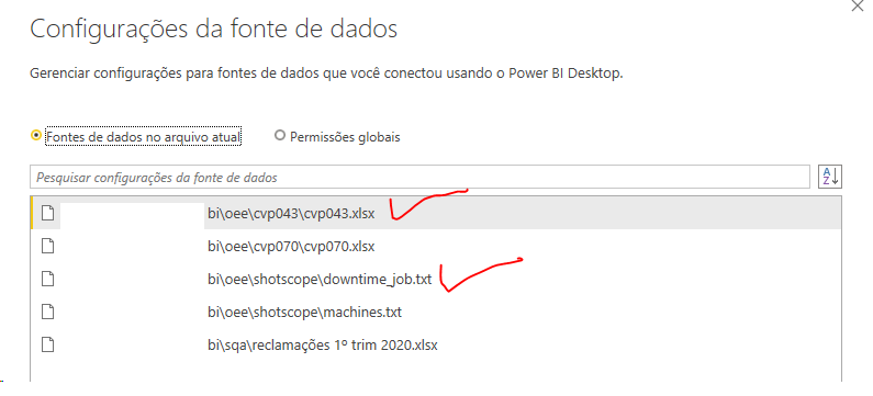

      My problem is that by placing the previous day’s file in the folder and updating the BI, it overlaps the data, it does not increment.
      How do I today not to lose data? I have a file that has the information from 01/01/2020 and I always add the data at the end of it, do the manual increment and the BI every day reads all the lines.
      I showed the folder structure, in another image, where the files are generated there.
      I’ve done all the necessary configuration:

      So is the query source a folder or Excel file?Ā  From the image you displayed, it looks like the query is from a file.Ā  You need to change the query so that it gets the data from a folder…Ā Ā

      I have the separation by folder, where each file is generated.
      But as I understand it, I must save all files there, and PB recognizes and does the magic, correct?
      I will test it that way.

      , That’s correct.Ā  You’ll need separated folders for each data source where you are incrementally adding files.Ā ?
