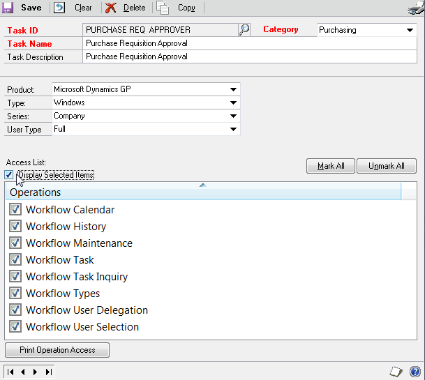

      Hi Brenda,
      You will need to add security to do this, you can add it to a task such as the TRX_PURREQ_026
      see the screen shot I attached.  let me know if this helps.

    • Brenda Button
      April 10, 2017 at 11:21 AM
      Hi Jonathan –
      Thank you for your reply!
      The odd thing is this person’s security has all the workflow tasks selected.  Still no access.
