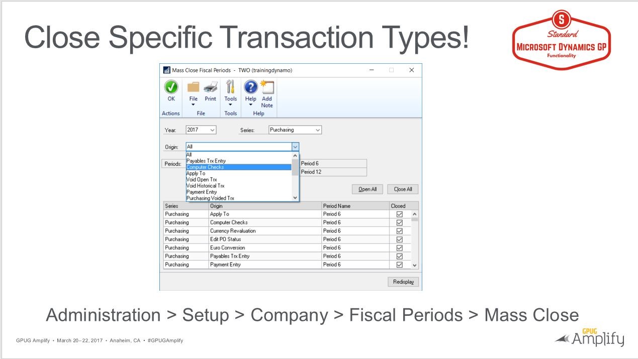

    • Amber Bell
      March 14, 2017 at 3:56 PM
      Hi Steve,
      Have you considered using the Mass Close (aka Mass Close and Super Specific Close) button on the Fiscal Period setup? You could “Close AP” for everything like Payments and Voids…but keep it Open for Payables Trx Entry.
      Admin > Setup > Fiscal Periods > Mass Close
      This doesn’t break the Doc Date Verify. It would just be keeping AP Transactions open (since that specific window should be kept open based on your notes above).

    • Amber Bell
      March 15, 2017 at 3:40 PM
      I am honored. This is actually one of the tips I am going to demo at GPUG Amplify next week! If no one likes this one, I will tell them that it is a “Steve Erbach – Leslie Vail Gold Badge” award winning tip!!
      Here is my slide for next week. (I used a site http://www.canva.com) to create my little “Standard GP Functionality” logo.

    • Amber Bell
      March 16, 2017 at 12:08 PM
      Hi Steve,
      From your original post, it looks like you are using the Posting Date from the batch…even if you were not, here is what would happen and why I suggested opening the Payables Trx Entry:
      Your user is entering and wants to Post with a transaction date to a closed Period. I think you are closing AP and GL to control what hits the GL. I would suggest keeping the GL closed for the period but opening the Payables Trx Entry window.
      Example:
      AP Invoice Date 03/15/17
      Batch Posting Date 04/12/17
      If you Opened the Payables Transaction Entry for March, but keep March GL closed…this would post without problems. If someone posted without a batch, the system will not post through. You would see this (unless they manually overwrote the GL Posting Date by clicking the Blue Arrow by the date on the transaction)
      GL Posting Date 3/15/17
      The AP would post just fine…but the GL batch (that would need to be posted separately) will not post to a closed period. The problems would kick in if the user changed the date on the Journal Entries and then posted…because now AP and GL would appear to be off.
      My recommendation is to prevent this by turning off “Allow Transaction Posting” and turn on “Post Through”. I tested. The Edit list doesn’t show the Fiscal Period is closed message…but the AP batch goes to batch recovery and won’t post because the GL date is closed. That gives the user the change to fix the GL Posting date if needed.
