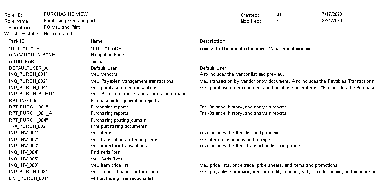

      I have a user setup with limited security that needs to be able to print purchase orders.Ā  I gave them the following rights but when attempting to print he gets the message ‘you don’t have access to this document type’.Ā Ā
      Version Microsoft Dynamics GP 18.2.1036
      What am I missing on his setup?Ā Ā

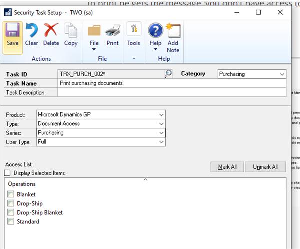

      Below is a screenshot of my local system.Ā  I am looking at TRX_PURCH_002* as one that you have assigned.
      The key in reviewing the operations relevant to this are as follows:
      1.) Pick your Security Task
      2.) Make your “Type” set to “Document Access” rather than the “windows” and “reports” most people are used to seeing.
      3.) Ensure that the appropriate PO document types are selected for the task you’re looking at.
      4.) Save any changes
      5.) Have the user log out and log back in.
      Give that a shot.Ā  You may need to review several different security tasks to find the one that’s most appropriate for you to add those document access points to as that may vary from company to company.

    • Penny Lyon
      August 21, 2020 at 2:22 PM
      Thank you.Ā  That was the issue!
