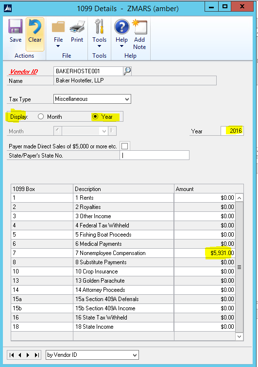

      I am not sure that you can split the transactions already posted between the two, but you can add his new FEIN and vendor name as a new vendor. GP allows you to manually enter the 1099 amounts per month, even if the transactions did not occur through payables.
      For the current vendor you have setup – I would edit the total in box 7 to total what should be the amount for the SP – make sure on that vendor card you have the SS# & proper name setup.
      You can edit the 1099 details by going to Purchasing-Cards-1099 details.
      Once in the window – change the Display to Year & manually enter the amount to be 1099d for the year in box 7. (Also – make sure the correct year is selected in the year box
      Next, you will want to setup the LLC as a new vendor – then repeat the steps above and enter the amount in Box 7 that should be 1099d for the LLC.
      Updating the 1099 details will not effect your payables history – it will just ensure that the 1099s you print are accurate.

      also AMy, When in cards>Purchasing? 1099 details, I can’t seem to edit or change box 7. AM I missing a step?
      Or do I need to go to purchasing .edit 1099 details which gives me this:
      Burgen Havens
      Rancho Santa Fe Fire Protection District
      Rancho Santa Fe CA
    • Patty Stepp
      February 22, 2017 at 12:12 PM
      Use the 1099 Details screen to edit the totals.  You must change the radio button from “Year” to “Month” before you are able to change the numbers.  You can change all months or just one.  This is summary information so determining the difference you need and changing one month should be fine.   After to enter the amount and save it.  Pull it back up with “Year” selected to verify the total is correct.  Once the total is correct, you can reprint your 1099.
