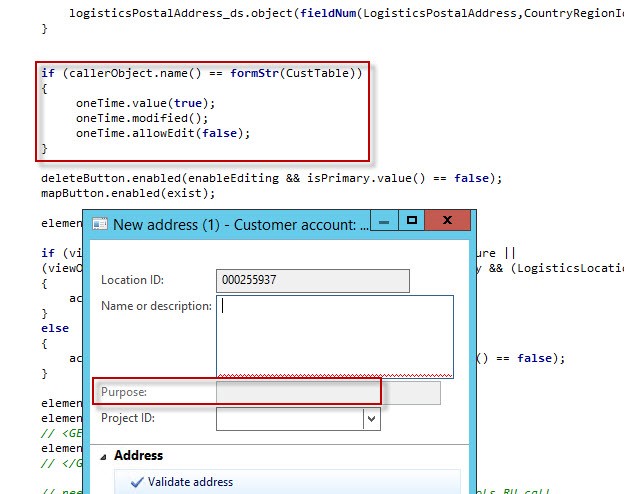

    • Rudy Salcedo
      March 16, 2017 at 1:06 PM
      Thank you all for the suggestions.
      Lloyd, I added the code that you suggested to the updateControls method of the LogisticsPostalAddress form.  I wasn’t sure where to add it, but I wanted to see the effect.  When I tried adding a new address, the Purpose was blank, and I am unable to access the dropdown to select a Purpose.  I understand why we would not want the user to modify the Purpose field, but how do I default a specific value in that field?
      Also, when I try to edit an existing address that has a Purpose in the customer addresses fasttab, the Purpose field is also blank and the dropdown cannot be accessed.  Did you have to add code so existing addresses would display their Purpose and could be modified?
